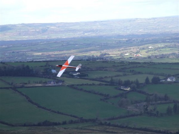

« Reply #45 on: March 09, 2009, 06:29:32 AM »
And here is the Phase, after all the trials and tribulations, finally doing what she does best.
(Photo by Maciej)
Brian

Hi Keith,
It looks better there than in the bin ?? :D .
