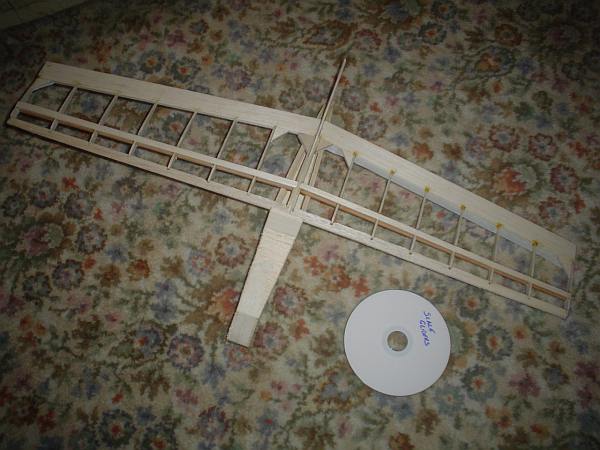

Yeah, meant Paul Janssens.
I've had a few of his plans knockin' about for a while now. I will go for either a 1.5m Seafury. Which will be a decent size with chunky fuse. Or a 1metre Mirage 2000. The Seafury is foam veneer wing and fuse. The Mirage is a lost foam fuse and a built up wing. Both have been scaled up from the original plans.
The original 0.72metre version
Original 1.12metre version

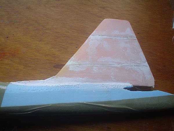

I have attached the vertical fin to the fuz and tomorrow will finish fairing it in to the main fuz. Then I'll be abe to apply the carbon, kevlar and glass.

Fin attached to plug and ready for fairing in. Then I'll get the glass and carbon on it before melting out the foam. Put a couple of balsa ribs in the fin for strength.
