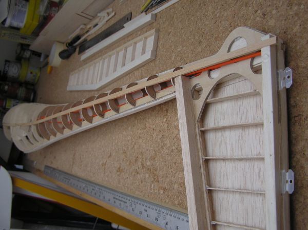

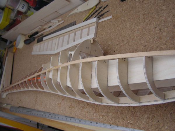

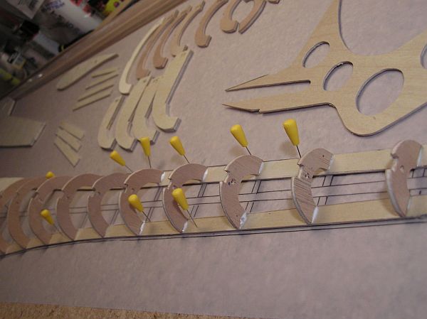

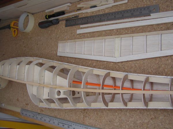

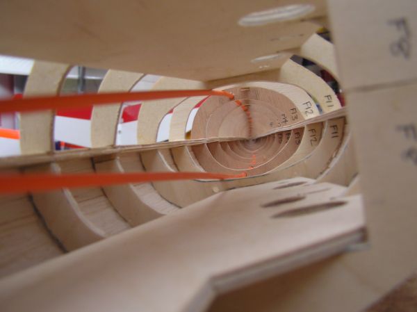

Here's some pictures of an ASW 20 build from a Mike Trew plan - a stable mate for the Pilatus B4.  Another planked fuselage!  So far so good.

Meticulous work Peter, well done. :clap:
I admire your tenacity. Thanks for letting us see your handy work in progress

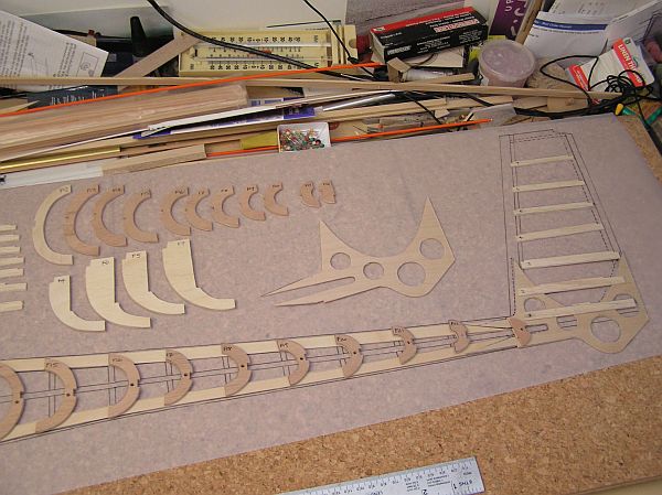

One question,……your workshop doesn’t look like a greenhouse. So why is there a max/min thermometer in the first picture???  :lol:

Keith - my work area is on a return attic landing with an overhead Velux window and no heating - its boiling in the summer and freezing in winter - hence the max/min themometer! Started this build straight after Christmas - although I had been doing some fret sawing for about a month before - targeted two formers a day!

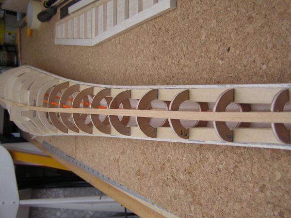

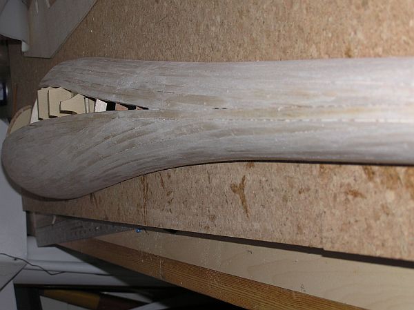

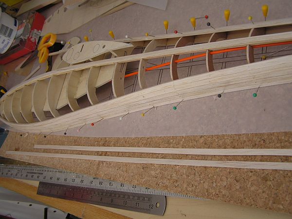

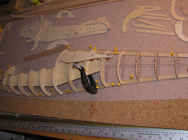

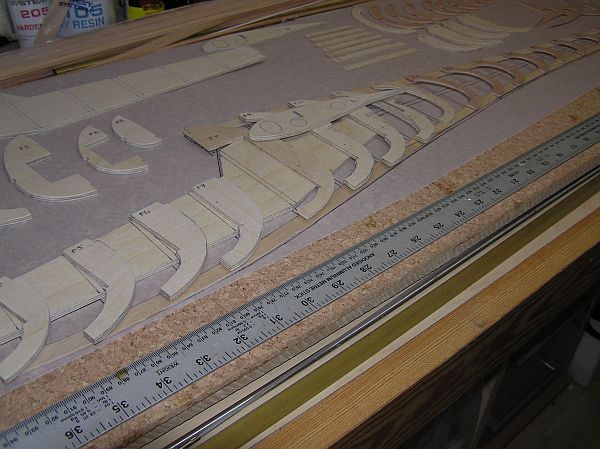

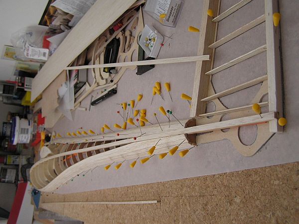

Good to hear of those other ASW 19/20 builds going on out there.  Here are some more pictures of progress with mine.  I built directly onto the planked first half of the fuselage - I find it easier to install the controls, particualrly in the tail - doing it this way.

Thanks very much for your pictures Peter, they will be very helpfull when I start my own building.
Did you choose which version you're building, 19 or 20? The only difference between the two versions is the flaps, is that correct?
