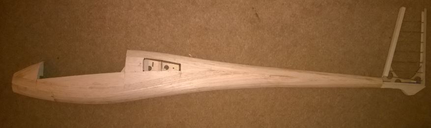

ASW 20
« Reply #48 on: September 13, 2014, 22:46:19 PM »
It has taken a while and my first ever planked half fuz is done.
No where near perfect, however it is straight and it looks right.
Next challenge is add the other half to the first half and then make it all smooth.
I have a plan to make it smooth adding 1/32 inch sheeting over the current planking  as it can be added in long wide strips.
Alistair

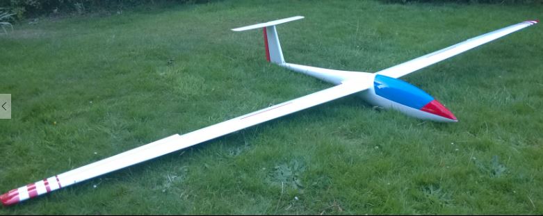

« Reply #52 on: August 31, 2015, 21:27:03 PM »
Well after nearly a year I finished my ASW 20, thanks to Joern for the encouragement.
Now on with the Pilatus B4,
Alistair
