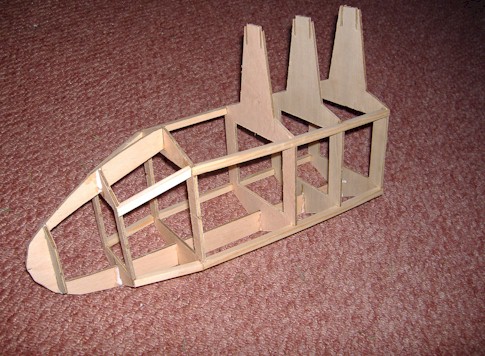

« Reply #13 on: January 08, 2007, 08:09:51 AM »
Hi there,
After a Saturday at the slope, a bit of work has been done sunday on the Opel, starting with the fuselage. The pieces :
Not a lot ! So, that goes really quickly to assemble :
After that, not a lot of work need to be done on it. Plywood sheeting, and space for the pilot, batteries and receiver.. Yep, no servos on the fuselage, they are all in the wings and tail !
First look at the fuselage with the wings :
Well, looks like the picture... Always a good sign !
