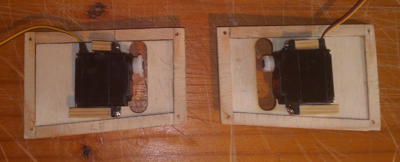

Back to work this week so less time to build :(
Added a frame around the servo plate and sanded it down so the servo plate was a nice snug fit.
Repeat for other plate. Cut some wood and glued to plate for servos to mount on to.

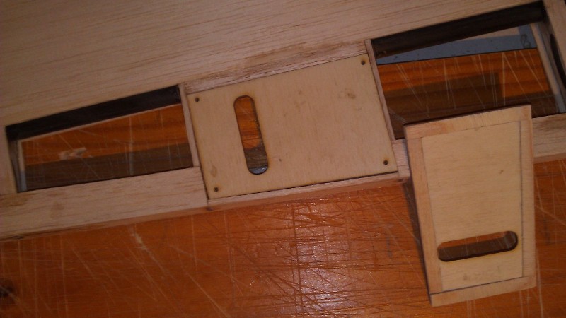

« Reply #288 on: July 04, 2012, 08:14:31 AM »
Again really nice work Alistair, I noticed Fred's Quark had his aileron servo mounted on the actual servo cover plate.
He had an aileron servo failure when I flew with him on Mt Leinster and he had the servo changed in a matter of minutes. I thought it was a great idea especially if your landing site has a rough landing area.

« Reply #289 on: July 04, 2012, 18:03:11 PM »
Richard thank you again for the encouragement. I will indeed have my servos on the plate as per this picture.
Will add some fibre glass and epoxy to strenthen the wood on the plates.

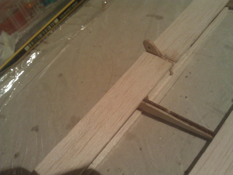

alibodin
  • Posts: 77
« Reply #292 on: July 05, 2012, 18:01:23 PM »
G,
Your Quark is looking good.
I am about to do my horn and will take pictures later. The horn will be 1.5mm ply and glued to the aileron spar and top sheet at the front of the aileron. I will then add block balsa either side glued to the horn, top aileron sheet and leading edge of aileron. Finally I will add the front sheeting either side of the horn.
Here is a picture that hopeully clarifies what I am doing.
Hope it helps.

alibodin
  • Posts: 77
« Reply #294 on: July 05, 2012, 22:03:29 PM »
Here is the completed aileron horn.
Need to add cap strips to aileron.
I have yet to do my wing tips. From pictures I have seen they are not shaped as they are flat at end of wing. There may be a little rounding of the leading edge at the wing tip.
I actually plan to add wing tips so as to protect the aileron for the ocassional cartwheel landing I do. :) Also some protection for transporting as well.

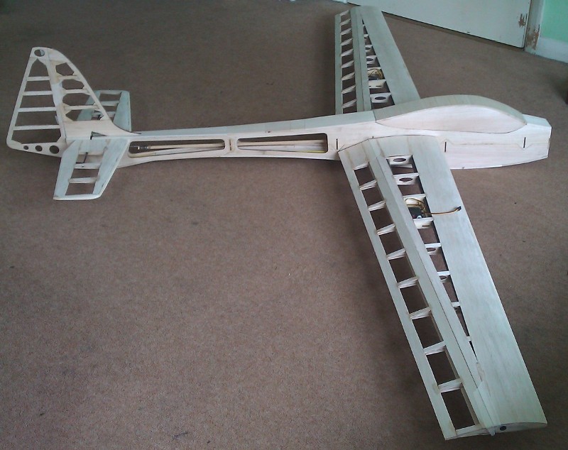

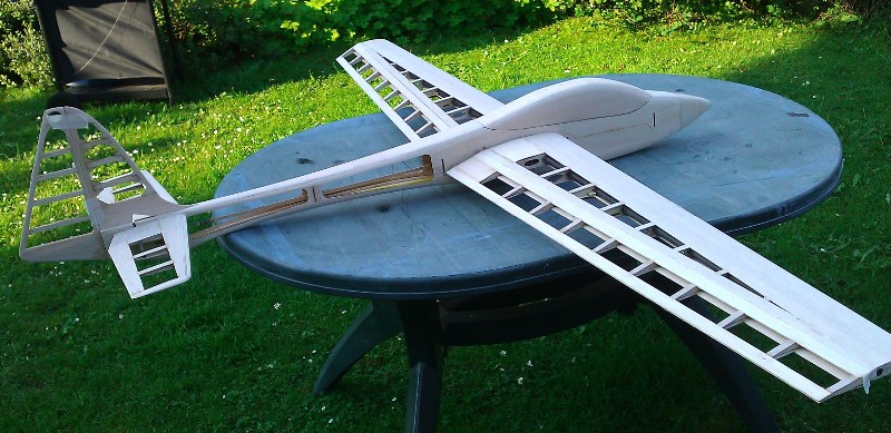

« Reply #299 on: July 08, 2012, 19:01:04 PM »
Well my Quark is now ready for covering, shaped and nose added as well.
Covering ordered and should be here soon.
Final sand down with smooth and ready to cover.
Weighed it and came in at 1281 grams.
